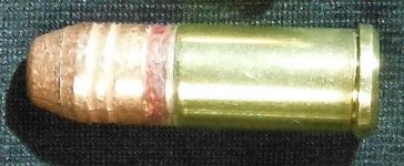

I shortened the Lee 45LC seater die by 0.3".
It works well for the cast 300 gr bullet at 1.555"
It does not work well for the 230 gr FMJ at 1.4"
The roll crimp die does not work on FMJ where there is no cannelure.
I am going to have to get a 458 Win Mag factory crimp die, make a spacer bushing, and put the 45 auto rim cartridge in it upside down. I have done this for 32 S&W long with a 308 die.
  • 45 auto rim with 300 gr cast crimped with 45LC seater shortened 0.3 in 8-5-2012.jpg
  • 45 auto rim with 230 gr FMJ crimped with 45LC seater shortened 0.3 in 8-5-2012.jpg
