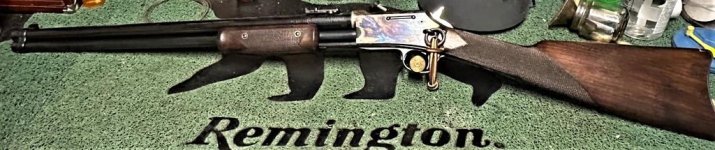

Have a Pedersoli Colt Lightning in .45 Colt. I tried shooting some of my handgun loads through it and the accuracy is not real good. I was using a 250 grain cast RNFP with 5.6 grains of Bullseye. This duplicate the War Department loading that was required for the Colt Model 1909 U.S.Army.
My question is what are you using in a 16 inch barreled carbine?

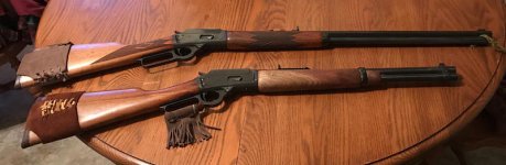

I rebuilt my wife’s carbine into a trapper. Turned out nice. Run the same ammo in both.Fringe is gone. Added a saddle ring to eliminate the safety. Also added a carbine rear sight. It will hold 10 Schofield loads. If I could get it to run 45CS loads I would seriously think about making it into a true Trapper and sbr it. The top rifle is a Cowboy Ltd with a 24 inch barrel.
