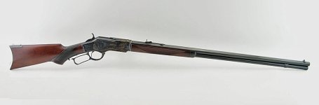

I have tested over 30 different powder/bullet combinations over the years in my Uberti '73 Deluxe, 30" and the most accurate of all was a load using 8 grains Unique and a 255g RNFP. Averages 1130 fps and shoots 2.5" groups at 100 yards. It is the one below, except I added a Lyman tang sight.
