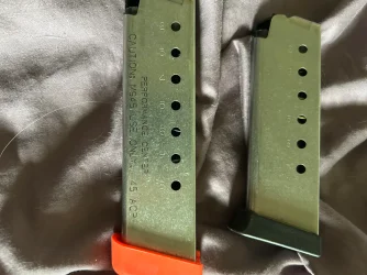

Sevens has cover this before . The early 945 8rd mags have 2 slots , they were taking 8rd 45 mags and cutting the slot for the new 945's , then marked them PC . The 457 mags are 7rd , don't know if they'll fit the smaller 945's or not . There's also the 40cal 945 .IMG_2924.webpIMG_2923.webp
OK so that raises the question - are the 945 8rd mags the same as 4516-2/457 mags. As I recall the 645 mags had metal base and may (or may not) have problems with the later plastic base mags.
My bad - I was thinking 945 8rd vs 4506/4506-1 8rd but I got sidetracked and mixed pistols with first part of original post. Thanks cherrpointmarine for the reminder about the 945 mags and photos.
