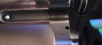

I had never heard before that S&W might have done action work on recalled L frames but I have always wondered why my "M" yoke stamped 686 is such a shooter. I bought it used in the 90s and it has the best single and double action trigger of any Smiths I have including the ones I put Wolff spring kits in. Because it is a silhouette model I always wondered if it had been given a trigger job by the previous owner, which still might be the case. Thanks to the posters on this thread, I have a new possibility.

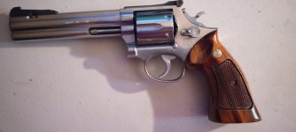

My first revolver purchase a few years ago was a 4" 686 no dash. I looked it up in the standard catalogue 4th Ed. and THEN I noticed the recall ! Being inexperienced with such matters I took the recall very seriously, and sent the gun back to S&W. It took 10 weeks to get my 686 back, but it shoots great ! They even smoothed out a rough spot on the ejector shroud ! I am very happy with the gun !They did stamp an M above the model number.
I bought and started carrying a 586 soon after they came out. Had no problem with any factory or reloaded ammo I used. Later sold it to a good friend, who had it tie up on some type of .357 ammo; he mostly shot his own reloads. I offered to buy it back, but he declined and sent it in for the "M" modification. Several years ago I acquired a LNIB no dash. I had no trouble with .357 ammo, but sent it in anyway. If I had it to do over, don't think I'd send it in. IIRC, I did have S&W give it a tune up while they had it. Cost about $60.00 I think it was. My current no dash is definitely not going to be sent in..

My 581 arrived today. M stamped and new firing pin bushing & what looks like new firing pin on the hammer.
Now time to get a decent set of grips…..
Was finally able to get to the range with my 581. It shot well, over 50 rds at some near and close targets in my adhoc IDPA stage, moving while shooting with some strong hand only shooting.
I'll admit, the front sight is tough for me to see, especially in comparison to my SIg P365 w/ X-ray sights. Will try a simple paint the front sight trick first to see if that helps.
Like the gun quite a bit. Still need to get new grips for it
