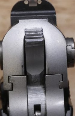

Maybe a little late for your pistol if you have had it for a long time, but still good info and on topic for others is that during reassembly, take care when putting the slide back on, especially when you bring it back over all the levers.
Ham-fisting things here WILL ding the levers in to the rear of the slide and leave telltale marks on the rearmost back end of the slide on either side of the cutout where the hammer falls.
I grabbed this picture from an internet search… this might be a 645 or possibly an early 4506, but it shows the dings I am trying to describe:
If you buy old issued duty guns, former LEO, DOC or security companies, you are definitely gonna have these marks.
But if you find old time capsules, you have a chance to keep them looking nice by taking care and depressing the levers before you smack the slide in to them.
^^^^^ yeah most used ones I've seen have at least faint marks there. Interesting design for sure.
