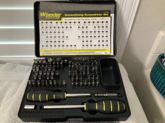

Yes, I would say that will do !
WM, it’s your gun. Do whatever you want. But chances of that thing being better after you “pop off the side plate” than what it is right now are slim and anorexic.
You have the screwdrivers bits, and are a real smart guy, way smarter than I. Everyone is. If you’re sure that a barely used gun has gotten so dirty that it needs disassembled, cleaning, why not just take the grips off rinse that thing out before you tear into it. I’ve seen dirty guns run pretty well.
I recently bought a 686 manufactured in 1983. Obviously fired very little as most of them are. The action was rough and gritty. Sounds very similar to yours. I put in snap caps, and dry fired it, possibly a thousand times. It’s pretty slick now. No disassembly required.

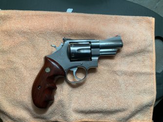

Welcome to the S&W Forums.
You have purchased what is likely a fine revolver and needs only a good cleaning and light lubrication with oil, not grease. It is 39 years old and likely has never had a full cleaning and the lock work may be coated with debris and old, dried lubricants, maybe even WD-40.
This, a thorough cleaning and lube will do wonders I’d bet.

All I can give for advice is... oil the interior of that 3" .41 first and slick up the action (I bet it is dry as a bone.)
If you are gonna shoot it... 210gr LSWHP with a modest change of Unique will do for most uses. Nice leather flap holsters are for sale on line.. suede lined is what I'd get.
