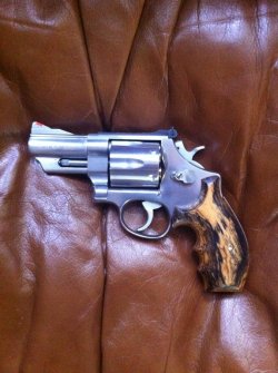

I just purchased my first revolver a 1986 657 41 magnum off guns.com.
I was super nervous to purchase a revolver site unseen, but I finally was able to pick it up.
You can only see so much on the pics on the site, but it did look fairly clean.
Upon inspection I could have not been any more happier with it.
This 39 yrs old pistol was in excellent condition, I was stoked.
One thing when I was dry firing it after pulling trigger it had a little gritty bump before it reset, is this a common issue?
From looking at the screws it looked as if it has never been opened up unless someone had a set off armorers screw drivers and did it right.
So I am hoping it just needs to be greased up again, anyone have any advice?
Second question, I was thinking of sending it back to Smith & Wesson and getting a trigger job done.
They have an outdoors package where they crown the barrel, would this be blasphemy to do to this pistol ? It’s a 3 inch barrel.
And last but not least is the performance center the folks to work on this pistol ?
Any advice would be greatly appreciated.
You probably just need to open it up and clean it really good and just a few drops of oil. That's going to take the grit out. I can do a professional trigger job on if for you. I'm a master gunsmith and Smith & Wesson armorer. But yes the Performance center would be who would do the trigger job if you send it to Smith & Wesson
WM, it’s your gun. Do whatever you want. But chances of that thing being better after you “pop off the side plate” than what it is right now are slim and anorexic.
You have the screwdrivers bits, and are a real smart guy, way smarter than I. Everyone is. If you’re sure that a barely used gun has gotten so dirty that it needs disassembled, cleaning, why not just take the grips off rinse that thing out before you tear into it. I’ve seen dirty guns run pretty well.
I recently bought a 686 manufactured in 1983. Obviously fired very little as most of them are. The action was rough and gritty. Sounds very similar to yours. I put in snap caps, and dry fired it, possibly a thousand times. It’s pretty slick now. No disassembly required.
What does the owners manual say?
Yes, I thought that would be a bad move to crown. I will look into how to disassemble and clean and oil. Thanks for the advice.
Get the right size screwdriver and cradle it with your thumb on the surface of the grips and then tap them off ,do th le same for the sideplate, tapping the frame with the plastic or wood part of the screwdriver where the grips once we're until it loosens the sideplate and then with your fingers take it off. Never pry thr sideplate off, and spray some Birchwood Gun Scrubber in there liberally. Let it dry then oil up the contact points inside.
