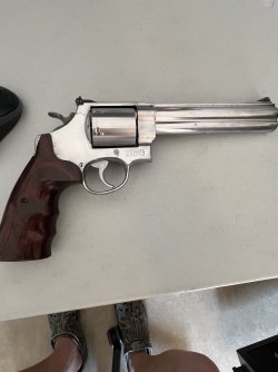

i picked up a 657-4 this week the condition is ok, it has a ccr serial number 6.5 barrel has hunter classic on one side of the barrel and smith & wesson on the other side. can someone help me with the date and some history please? i saw it at a pawn shop and had to have it! IMG_0291.jpeg
