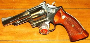

I am looking at what I suspect is an ex-duty gun- 4", stainless sights, pre-gas ring misadventures, target grips skillfully modified for improved speed loader access, butter smooth action, and lots of holster wear/minor dings. I like that these early guns didn't have the barrel extension flattened as much as the later examples. Price is $650. I will probably go back and check the end-shake and if the grips match the gun. Thoughts? I could always replace the front and rear blades with blued units, if necessary.

Rear sight has the stainless assembly with stainless blade. The front sight has a pinned (visible) stainless blade. The lack of the red ramp is big plus to me.

Well, I went back and checked it out again. The big issue is the end shake. Normally, this can be addressed with washers, but that would forced the cylinder gap to an unacceptable level (to me).
Sigh...
