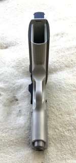

Here are the results of the ambidextrous safety install. After carefully fitting the part, it functions perfectly and the finish matches almost exactly. The thicker frame made almost no difference in the fit and function of the parts (.007). The grip panel was grooved for this option and allows proper throw. So a successful endeavor and completely reversible.

Good job looks great. I'm glad it worked out so well for you. Thanks for the update.
It's amazing that all the grip screw slots indexed the same. :D Something I can attest to is that 1911 SHORT grip screws work perfect on the 945's. Probably just me but the factory large head slotted ones detract from the overall quality.
