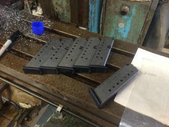

Lastly, one might look at one of the early original dual-notch 945 magazines and say, "hey, maybe I could modify a 4506 magazine and replicate that!"

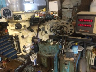

In my experience, yes, you can! I cannot imagine pulling it off well or accurately with a Dremel, but some folks are pretty skilled. I have six modified magazines that my buddy did with a mill that weighs as much as my car.
These magazines are -ALL- that I use for my 945's. My OEM official 945 mags are tucked away. I only use these six modified magazines.
If I were still in contact with my buddy, maybe I would make a slew of them… however I am not, and no, I cannot replicate this feat for others. But anyone with the equipment surely can.

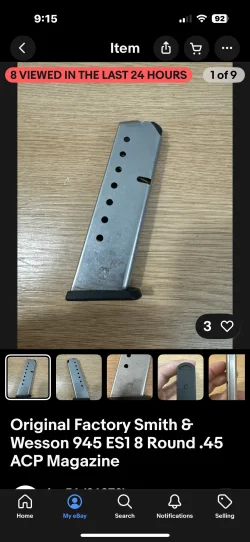

Unfortunately I arrived too late, the mag was sold when I found it, I really appreciate your notification "7secondgta"!
