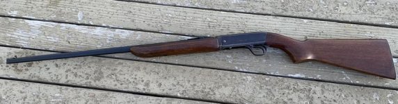

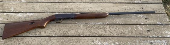

My brother has a grandson named Remington and he’s been on the hunt for a Remington .22 to give him in a few years. He was shocked at the going rate for Nylon 66s, and I told him I’d keep an eye out for something.
Local place took this in on consignment. Remington 241, their version of the classic Browning design.

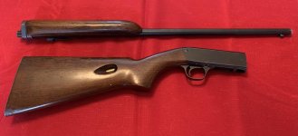

The stock was wobbly but tightened up fine. Its a takedown, and it fits back together solidly.
Stock has some minor rough spots, but that’s easy.

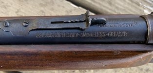

I’ll have to keep an eye out for some of that “greased” ammo!
This is my first time with this design. The Browning were always a little pricey for me. This one seemed right at $250.
Any fans? Anything to watch for?

When TD either of these,,or the FN,,hold on the Frame itself to twist the bbl apart from the frame.
Don't be in the habit of holding onto the stock when TD and re-assembling.
This can result in the stock cracking at the inletting cuts at the frame juncture.
Many of these rifles will show cracks there.
The 'Greased' ammo was Remingtons KleenBore 'Greased' brand ammo at the time.
The other recommended ammo for these was Peters 'Rustless' .22 ammo.
The owners manuals refered to other ammo as 'oldfashion' and if you did use it you needed to clean immedietely to avoid rusting. Mentioning the boiling water treatment, etc.
The outside lubed bullet .22rf ammo was earlier Wax lubed. That worked just fine in revolvers, bolts, ect. Not so well in semi autos where the wax built up in the chambers and throat and left the bolt only partialy closed at times.
The Greased lube overcame that pretty much and allowed the bolt return spring mechanism of the semiautos to ram the new rounds home in the chamber w/o a problem.
Some semiauto pistols especially Target pistols still had issues.
Lightweight return slide springs often didn't have the power to chamber rounds with a slightly gumed up chamber.
So pistol shooters would often wipe the individual cartridges with a lightly oiled rag to take most of the grease (or wax) off of them for 100% feeding and chambering in Match shooting.
