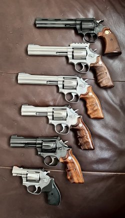

Here are my rimfire revolvers:

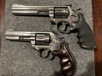

Below is my 617-6, next to a 617-1, both are drilled and tapped, one is RB, the other is SB, one is a 10 shot, the other is 6 shot. As you can see, aside from the above differences, they are very much alike.

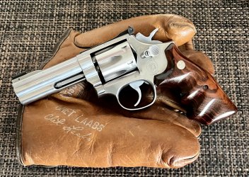

And this is standing with irons on a Sun afternoon. A small redot will only make them better.
