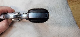

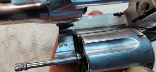

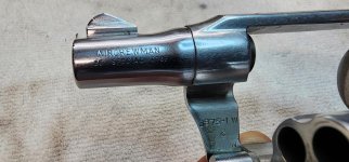

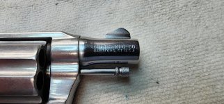

I recently obtained this Colt Aircrewman and I am having a hard time finding out some information about it. It does not have the Property of US Air Force nor does it have a serial number on the butt. Here are some photos if anyone can help.

RKHarris - The butt and back strap have had the markings ground off and then the gun was nickel plated. The number inside the crane is the serial number. The number that was ground off the butt was A.F. No. XX--the Air Force issue number.

Value
What would you think the value would be given that it has been altered?

Well, I hope this doesn't sound too harsh but it's value as a collectible has been reduced to zero and, given the aluminum cylinder and frame, it isn't a good shooter so....
