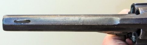

This is what appears to be a Belgian manufactured copy of a first model DA. It came from a gentleman in upstate New York who served as an Officer of the Imperial Russian Army during the First World War and later the White Army in the Russian Revolution / Civil War. Imperial Officers were expected to purchase their own side arms – revolvers, shashkas, sabers etc. These were purchased from Officer's Supply stores in St. Petersburg, Moscow and other major cities. There are lots of surviving ads for these stores showing Smith & Wessons as well as other European designs.

This revolver has been USED! It is worn way past where it would be safe to shoot. It was originally nickeled but the finish is 95% worn off with only traces remaining. It has S&W logo grips (copies?) and what is left the top strap marking has what appear to be patent dates. The top rib roll stamping isn’t straight and doesn’t appear to say “Smith & Wesson”. The cylinder cutouts are different from an original. The rear cylinder face has a Liege proof and a star over ‘X’ inspector's mark. The extractor star has a number ‘19’ mark which appears to be an assy number. This number is also found on the front face of the cylinder and on the bottom face of the latch, no number is found on the barrel. The trigger guard is the biggest giveaway that it isn't a real S&W - it bulges down below the frame where an original trigger guard would blend smoothly into the frame.
The original finish appears to be nickel – now long gone!
Top strap markings – hard to read.

Joe, Nice post. These old S&W copies are real reminders of times past and their study can be fascinating, especially if you have some real provenance for them as you have found on this gun. Belgian proofed S&W copies are almost endemic, especially the double actions, it seems. We have all seen 100s of them in our collecting years and some I would say would have been almost as much danger to their owners, as any target the shooter sought to hit. Quality control was not a concern! Ed.
