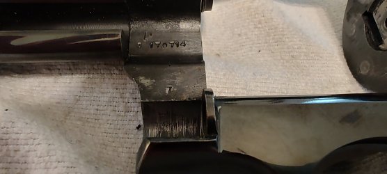

Good to know on both replies. Mine does not have the serial on the barrel or yoke either, just the butt and inside the frame under the yoke.

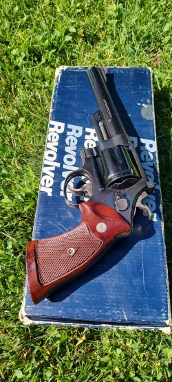

I was guesstimating mid to late 57 on production date. I am thinking about getting a letter done on this gun as well as my Grandfathers S180614 serial Pre 29 that he bought new I estimate in 1958.
Inside the frame under the yoke? Don't think there is supposed to be a serial number stamped in the yoke cut. A photo of that number would be helpful.

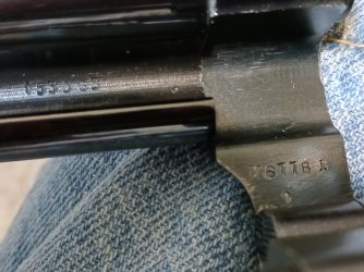

I have a 5-screw Pre 29 S153063 that shipped December 14, 1956. Since that is before soft fitting ended it has numbers on the butt, cylinder, in the barrel shroud, yoke and behind the star. In the yoke cut it has an assembly number.
I lettered mine. I have an invoice dated July 30, 1958. Serial numbers for 6 1/2" 44 magnums range from S171432 to S181468. Twenty were shipped on that invoice.

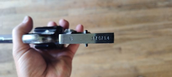

Here a picture of the frame number and butt number.

You're welcome, I'm glad I could help you out, especially me being so new here. My grandfather's .44 Magnum has the numbers in the same place as mine. His is an S 180xxx serial.

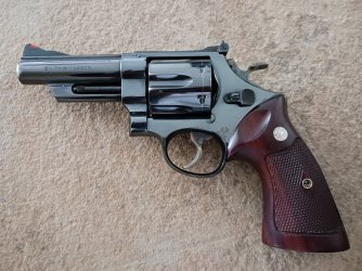

And that is a beautiful guy you have, I want to add a four inch to my collection. And yours has the same silver sheen that my grandfather does, mine seems a bit darker. I don't think mine has been refinished,however I'm not 100% sure about that either.
I appears that you’re correct, a replacement cylinder. Although the barrel and cylinder serial numbers were eliminated along with the soft fitting process we still find them numbered occasionally due to gun assembly in process, etc. But the serial number on the extractor star was not eliminated until long after when the shape of the star was changed.
If guns were reworked during manufacturing and had to be taken apart, the cylinder (rarely the barrel) was stamped with the serial number, but without the S.
Bill
