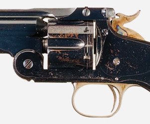

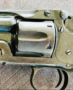

Hey Mark,
Interesting piece. I'm wondering about the cylinder length? Kinda looks like a long frame from your photos.
Photo 1&2 are Revolving rifle cylinders. Photo 3 is zoomed in on one of your photos.
Notice the Revolving Rifle has a short cylinder and long forcing cone. Most were actually made in 1879-1880. So short frame only. If yours is in fact a long frame then it can't be a revolving rifle.
Murph

I will have to disagree with you on this one Murph. The frame looks
right to me. The barrel isn't correct but we know this. The long exterior
conical taper on the breach of the barrel is different (it isn't a 'forcing
cone'). I assume this was done to allow the gases to escape and reduce
fouling clogging the cylinder's rotation.
The real interesting thing (to me) would be to see if the butt stock
serial number matches. The butt stock is definitely from a 320 Rifle.
There are two points that identify it. One, there is a place for the op-
tional peep sight. Only the stocks for the 320 had this. Two, the long
lower tang. This was different from the butt stock that could be or-
dered for a NM#3 (short lower tang).
From the serial number, this 320 originally had a 20" barrel.
Cheers!
Webb

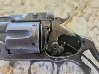

It appears that one ear of the hook on the mainspring is broken. Continued use as-is will break the stirrup at the cross pin.
Mike, You are correct. I got the old main spring out because of the broken side. Now how do I get a new one in and hooked up the the hammer?
Needed an extra set of hands and got everything put back together. Replaced a few of the screws too. Used parts from a NM3 Target in 32-44 that I had laying around.
Mark, this is perhaps too late but place the mainspring in the frame and tighten the strain screw. Place spreading type pliers between the mainspring and the frame just behind the hammer. Spread the pliers and attach the 'hooks' to the stirrup posts. It sounds easy but it really is a bit challenging. A third hand helps as you found.
