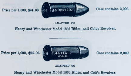

Winchester connection
I found absolute proof positive the 44 Henry Rifle, 66 Yellowboy, and Colt 44 Rimfire pistol were the first Frontier Rifle/Pistol combination introduced in 1875!!!
Directly from the 1875 Winchester catalog! Winchester also manufactured a dual purpose cartridge for the Henry/ Colt combo the exact year the 44 Rimfire pistol was introduced!
NO QUESTION! It's fact.
*** This would include all Smith & Wesson 44 RF pistols. During that period You would just have to make sure you are purchasing the correct box of ammo.
Murph

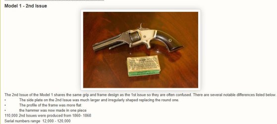

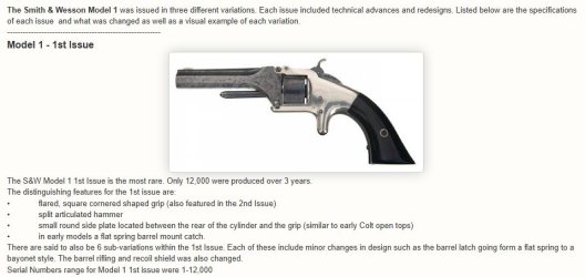

The first revolver S&W made was called the Number One. S&W designed
the cartridge it used which would later be known as the .22 short. It was
the only caliber offered for this model.

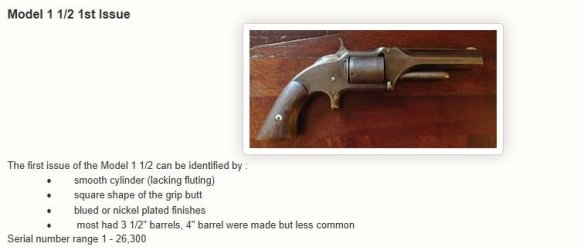

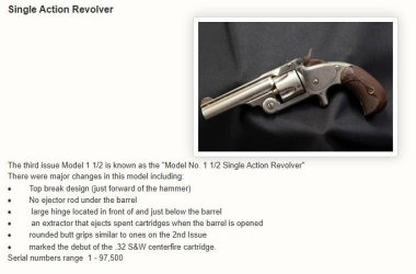

The Model 1-1/2 was made in three unique issues. The first and second
issues were available in .32 RF Only (not counting modifications made
outside the Factory). These were designed as tip-ups. Later, the .32 S&W
CF SA came out. Some call it the 1-1/2 CF but this isn't a Factory desig-
nation.

Hi There,
If you are interested in the history, that is fine. Go write a book.
But first off, you will have to stop conflating the facts. There is NO
Such Thing as:
"Smith & Wesson 1-1/2 2nd Model Revolvers (.22, .38, and .44 Caliber)."
nation.
The Model 2 came out in 1861 and was a big seller during the Civil War.
Some collectors refer to it as the Model 2 Old Army (even though it was
never adopted as a sanctioned Army pistol). None the less, these were
very popular with the soldiers. This model was in .32 RF only. In the
late 1870's, this model was replaced with the .38 S&W SA.
The revolver you have is the .38 S&W SA 2nd Model. Some refer to it as
a Model 2 CF. These came out in the late 1870's and proved to be more
successful than the Old Army model. These were only made in .38 S&W.
The only revolvers S&W made in .44 caliber were the S&W Model Number
Three (that is, until the .44 Hand Ejector series came out in the early 20th
Century). There are many sub-models made in the Number 3 model series
(like the American 1st and 2nd models, Russian 1st, 2nd and 3rd models
and the .45 Schofields).
So, get the facts straight before proselytizing to the quire.
Cheers!
Webb
