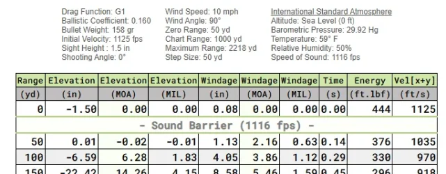

It is simply 7.5 grains of Unique that gets 1,125 fps at the muzzle in 4 inch barrel. It is over 400 foot pounds, not the 535 fpe of full power loads but right up there with most 40 SW and hotter than most 9mm Plus P. and even the 45 acp.
The data looks like this.
These are pleasant in a 4 inch gun and not bad in my 3 inch model 36. Certainly not wimpy but I cannot enjoy that 24 ounce gun very long with factory 158 grain ammo, which goes 1,205 fps in it.

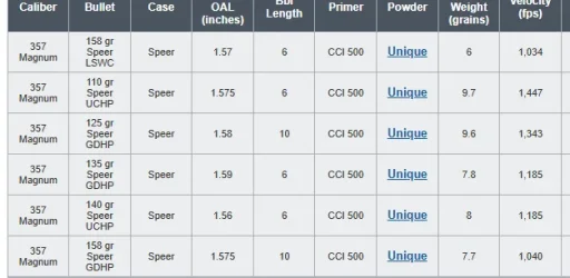

If you look at the Alliant site, they show 7.7 grains as a max load with Unique, surprising to me. Here is their chart. Certainly slower than my testing and they use a 6 inch barrel.

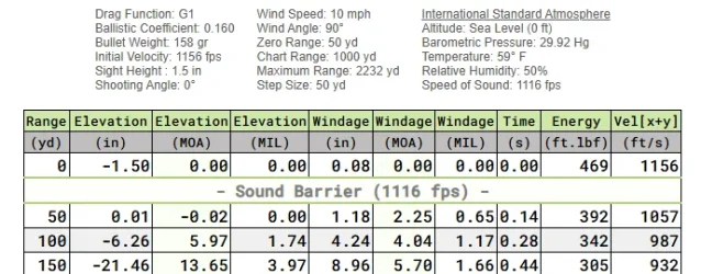

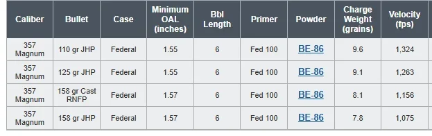

Alliant also tells us that their powder BE 86 is the replacement for Unique. Again their chart and it shows nearly an identical load and velocity for the 158 grain JHP. I note that they claim 1,156 fps with a lead bullet and 8.1 grains of powder which would bump the power up to 469 fpe. I may try that one but that is more power than I want for plinking, so probably will drop down from the 8.1 grains to the 7.5 grains and try to duplicate the load that I like so well. Even down under the speed of sound to maybe 1,100 fps would be fine by me.

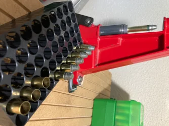

From previous post above. Well I reloaded
10rds 357S&W Mag with CCI #400 Small
Rifle Primers (SRP). I’ll try them next time out
practicing and also Chronograph them.

I got a chance after doing chores with the
sun almost gone to try out my June 2025
S&W 686 Mountain Gun with 4/10 of my
reloaded 357mags with CCI Small Rifle primers.
Single Action and Double Action worked just
fine. Firing Pin indentions deep enough to
fire Sm Rifle primers.
Unfortunately I was not able to chronograph
my new reloads.
Thanks for reading my post.
