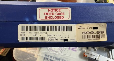

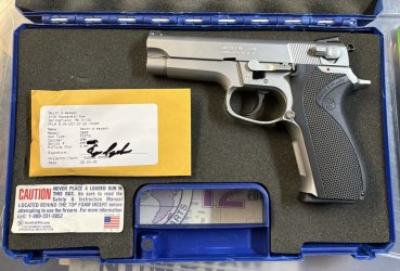

Hey, all. My brother-in-law passed away last year, and as I'm the only "gun guy" in the family, the estate sent me his 5906 that I picked up today. The serial number is KMFxxxx, it has a "U" used stamp on the trigger guard and a "used" box end sticker. The box still has the 2002-dated CoBIS fired casing for a state database (he lived in Ohio, so he didn't need it) and a 10-round AWB-era magazine. If my research is correct, these markings and dates mean it is likely a police gun that sat on an armorer's shelf at a police department before getting traded back in to S&W. Does that sound about right?

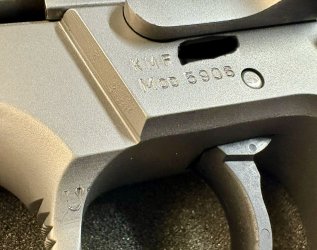

And has anyone figured out the KMF prefix (not listed in the SCS&W 4th), and which department(s) might have had them? I heard something about Kansas City or Kansas state police, but I can't seem to find that information now.
Most definitely a very oddball serial prefix — not just for a 5906 of that vintage, but it’s just not a typical serial prefix that S&W has used for anything mainstream.

From the roll stamped lettering, your gun is old enough to predate the laser marking era. Likely sometime early to mid-90’s at latest.
The fact that it has a 2002 dated test fire case shot by Gene Sypek says that it most likely came back to the factory as an LE used gun trade in, was inspected by a gunsmith, and test fired before it was sold as a used gun to a distributor. Gene Sypek is a now long retired performance center charge team gunsmith who could have inspected and test fired LE trade ins.
I doubt the K indicates a state except for KSP (Kentucky State Patrol 4566TSW)
There were several 3rd generation Kxx prefixes observed as early as 1998 and as late as 2003. Most of which seem to have been made in the dates above but most of the 5906 & 5946 seem to have been Surplused from inventory and sold years later circa 2023 with end dates in January 2019.
KJF for 5943, 4006, 910 one with 8xxx box end code
KLB for 5946 & 4566
KLF for a 5946 believed to by a NYPD gun and 3x 5906 with a 108176U Product Code and a box end date 011119 thru 011419
KMF for 5906 with a 108176U Product Code and a box end date 011119 thru 011519 (5 observed) plus a single KMF19xx dated by SW as 9/1998
KNC for 5906 with a 108176U Product Code and a box end date 011519 thru 011919 (6 observed).
I purchased one of the KNC group in 2023 when there were several dealers selling large quantities of "Used" but actually surplus NOS 5906 & 5946 pistols most if not all with January 2019 box end dates. A couple of vendors let you select from 10 or more S/N incl the above Kxx prefixes and several Vxx prefixes - all sold under 108176U or 5946 under 108186U product codes. SW dated the manufacture of my KNC11xx as 7/1998 despite the 011119 box end date.
I have also seen 1x 5906 with 608176 code and 2x 5946 VJP35xx with 608186 codes and box Ends marked "Used". I have one of the 2023 surplus 5946 also VJP35xx but code 108186U and date code 011419 but checked by SW = Manufactured 5/2009.
