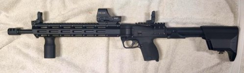

My current FPC setup is a Tandemkross compensator, UTG slim flip up sights, Magpul vertical foregrip, and a Holosun 510c-GR. The rear backup sight is attached to a Taccom scope mount. The sights co-witness with the optic.
