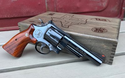

Since the S&W Model 544’s barrel measures .429, despite being chambered in .44-40, has anyone had theirs converted over to .44 Special (or .44 Magnum)?
Winchester factory .44-40 ammo has jacketed bullets that measure .426 with a dial caliper. So they’re inaccurate due to being too small in diameter to engage the 544’s rifling properly.
Hand loading .44-40 ammo with .430 bullets would fix the problem, but requires dies and the desire to reload the caliber.
Making the 544 into a .44 Special would make it shoot more accurately with factory ammo…or handloads which one may already be reloading.
It would also be a price conscious way to have the magical 5” N-Frame.
