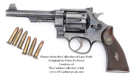

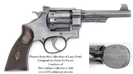

I can't answer where this one went, but it was serial number X23. Roy Jinks and Peter de Rose provided some photos and research to Larry Ruth for War Baby III. Attached is a photo composite of the right and bottom similar to the photos included in the book, along with a view of the left side.
Photos from the Collection of Larry Ruth
courtesy of The Carbine Collector's Club
www.USCarbinecal30.com

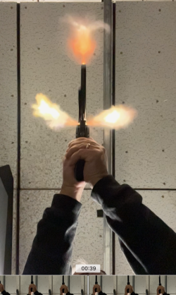

As posters above have referenced shooting through a Blackhawk provides both audible and visual feedback.
A screen grab from a slow motion video. All that powder that should be burning in the long barrel has to go somewhere.30.PNG
