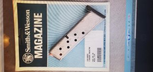

I removed the grips from the 539 to see how the mags insert.
Code:
https://imgur.com/GdWotyx
At this point is where much more force is required with the 639 mags.
Code:
https://imgur.com/ZEhYqZZ
There doesn't seem to be any obstructions or the slot being too narrow, which is good.

I just looked at your pics with grips removed,
Looks like it's the mag release engaging the top of the magazine, my bet is it has a burr or something and if you swap mag release buttons the problem follows the mag release to the 639.
