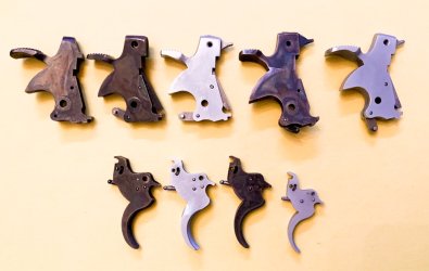

Have a nice case hardnened grooved trigger (NOT a wide target trigger) that I found but before I list it, I need to know the answer to the thread title. If they are different size, then I have no idea what frame this one fits.
... With the exception of at least the Model 69 (and possibly others) that has a larger diameter trigger stud, which I recently discovered to my chagrin!
Yes, I noticed that when trying to install a 620 trigger in a 66-8. I wonder when (or why) they made that change...
It's a great mystery to me too, as the standard 0.100" diameter trigger stud has never been a problem on any gun over the entire history of S&W to my knowledge. What they thought they were gaining by doing this, on only a select few guns no less, is beyond me. It's my understanding after talking to an aftermarket S&W parts supplier that it has become the new "standard" on the so-called "Combat" series revolvers. That being the case, maybe it's also in my new M19-10 as well? I haven't checked because I had no need or desire to change the trigger. The old standard diameter has worked just fine on even the heavy kickers and has proven itself over untold millennia of combined service. Why they would incorporate a change like this that requires a different trigger for just a few models, introduces the possibility of production mistakes being made, and adds complexity to their manufacturing steps and part inventory is baffling. The trigger doesn't exert high stress onto its post, I wouldn't think.
I tried to fit a 1917 trigger to an 38 Outdoorsman and found that it would not go over the hammer stud. I used a chucking reamer on the hole. I had the original hammer which had a broken spur and used a pin gauge to check if for proper size.
So there were some variations along the way.
It seems S&W is famous (or infamous) for puzzling variations throughout their history. Sort of like making distinctions between their M17 and M18, just when you think you know their standard design features for a given frame size and vintage and know what the major differences are between models, there always seems to be exceptions to every "rule."
