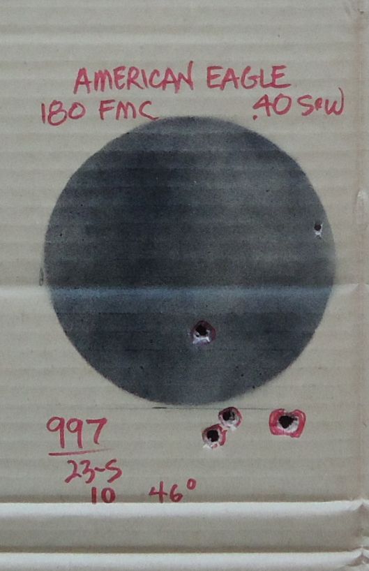

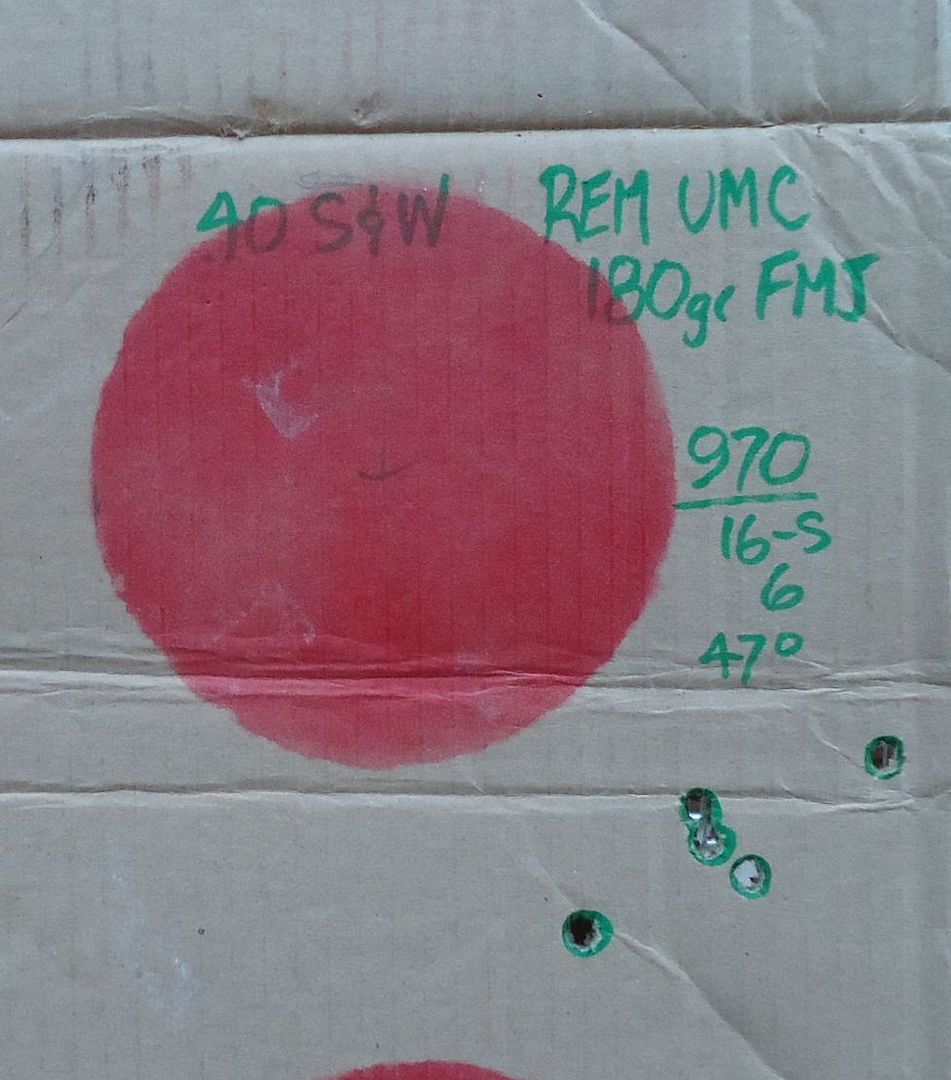

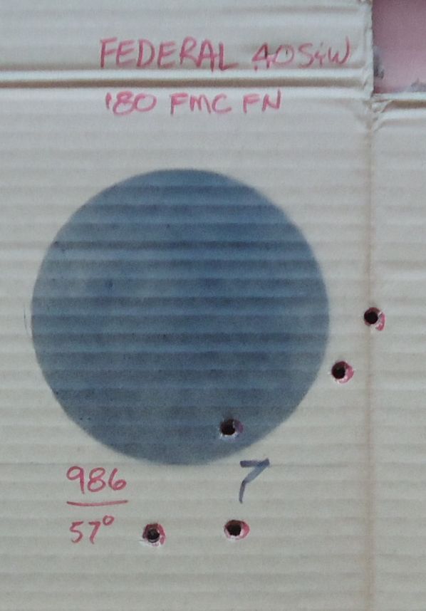

Everything was shot at 25 yards. Circles 5½"
Data listed top down;
Velocity
Extreme Spread
Standard Deviation
Temp F°

I noticed chronographing 180gr FMJ factory loads, they all fall in the high 900's. Must be a reason for that. I'll drop that load down some and see what happens.
http://i48.photobucket.com/albums/f...erican Eagle 180 FMC_zpsbo39ttlw.jpg~original
http://i48.photobucket.com/albums/f218/rafswede/40 S-W/RemUMC 180grFMJ_zps3uvaaiiu.jpg~original
http://i48.photobucket.com/albums/f218/rafswede/40 S-W/Fed 180 FMC-FN_zps33kkqiec.jpg~original
