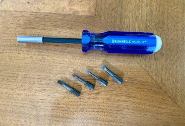

Brownells offers a S&W specific set of hollow ground slotted screw tips for their "MagnaTip" gunsmith screwdriver sets. The MagnaTip S&W screwdriver has 4 bits with the sizes needed to do anything you need on any S&W revolver. The smallest bit in the set is for those sight screws.

Brownells sells a screwdriver with bits that store in the handle purposely built for every screw on a S&W revolver. They are really nice
