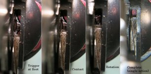

In the photos above it looks like the ratchets were contacting the frame before the center boss.

Observing the hand movement through its frame aperture, all of its contact is from the center and to the left.
It appears that only time the right side of the hand contacts a rim is where there is a notch in the web or ramp. (See photos). My conclusion is the hand's aperture may provide some support but the web are what keep the hand clear of the cartridges. yes, no??
I can't think of anything that would reliably fill that notch, other than, maybe a taller pin pressed into the cylinder.
Another route could be to angle back the right 1/3 or 1/4 of the hand's tip.
