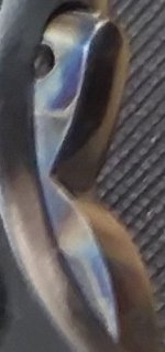

I bobbed the new style MIM hammer on my 360PD. I like it better than a 642 as there is still enough hammer left to thumb if I want to cock/decock on the range.
Basically, I just taped the gun up completely with masking tape and left only 2/3 the hammer spur exposed. Then I (took a deep breath and) cut it off in one clean slice with a dremel tool and abrasive cut off wheel. From there I just dressed the new edge with fine Emory cloth and jewelers file. I think it came out clean. (Sorry for the bad pics.)

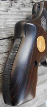

Here are a few of mine.
The factory bobbed Model 36-2s, Double Action Only and
My vanity Baby Chiefs, which I had a smith do. He also re-case hardened the hammer and trigger after he bobbed the hammer.

Basically, I just taped the gun up completely with masking tape and left only 2/3 the hammer spur exposed. then I cut it off in one clean slice with a dremel tool and abrasive cut off wheel. From there I just dressed the new edge with fine Emory cloth and jewelers file. I think it came out clean. (Sorry for the bad pics.)
If you get a chance sometime, can I see a close up of the hammer after you did this job? I am thinking of doing this. Thanks You for the info and pics too, just what I wanted to know.

I bought this one at a local gun show about a year ago.
Work was performed by a retired LEO who was an armorer for the Cincinnati PD. He also did an action job. This was his backup for a number of years and has proven to be a flawless performer for me at the range and is my current EDC.
