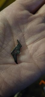

As of last night mine isn't extracting at all.
Went to unload it when i got home and the slide wouldn't budge. It's been a bit stiff like that unloading it before  though I've never had any issues with it cycling while firing so I wasnt too concerned. I just put it down to a bit of break-in hiccups.
So I dropped the mag and put some real elbow grease into it, the slide gave way, chamber opened but, the round didn't extract and I heard a little "tink" as the extractor hit the floor.
So it looks like mine is going back to S&W. Anyone out there having extraction trouble may want to keep an eye on their bodyguard. Luckily it happened to me in a safe environment but, any issues may be catastrophic failure in the making
Rudy, can you please post a picture of the part that went "tink"?
I totally believe you are saying to as it happened.....but how?
Was it the entire extractor? Or did it split and a piece come out?
The ever trusty and beloved Sig P365 had a string of extractors that broke had to be replaced due to some mix up at the makers. So it does happen
Like I think I said the slide just didn't want to budge so I dropped the mag and gave the side a good tug and she dropped straight out of the magwell

Yeah it's the main part of it, you're professional opinion is pretty bang on.
I've already penciled in a couple hours this week to be on hold with S&W customer service to get this sucker sent back.
