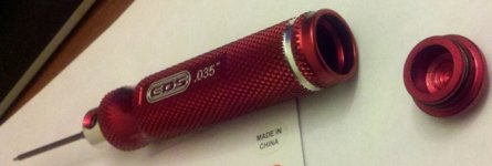

A little late to this party but here's what I found and purchased since I misplaced my adjusting tool. S&W did send me two in the mail as a courtesy, which was very nice of them. I then found this tool from a company that makes tools for Radio Control car racing. It was $9.95 and you can replace the tip. The top of the handle comes off to store the tip in and shorten the package, it's a really nice tool. It is .035"

The laser adjustment screw on both Bodyguards use a .035" hex wrench. The laser module anchor screw on the BG38 uses a .050" hex wrench. Until recently, the BG380 laser anchor screw used the same .035" wrench used for laser adjustment, but the 380's anchor screw was recently (September 2012) changed to the .050" wrench.
