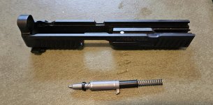

With the rear sight removed in anticipation of installing the XS sights tomorrow, I notice that the striker is not in a plastic sleeve as other M&Ps are. The striker is metal and does not ride in a sleeve of any sort. The striker spring is in a plastic sleeve. Leads me to believe that perhaps I should use a very light application of a lube of some sort, since the striker moves metal on metal. Of course S&W doesn't mention any lube for the striker in it's instructions. When I removed the striker, it was a little oily, but that could have leaked in there when I sprayed the rear sight with some PB Blaster the day before removing it. Anyone care to offer an opinion?
In the picture you can see that the metal is already showing what appears to be wear points at both ends of the firing pin carrier.
Most gun manufacturers recommend running the striker dry.
Did you field strip and clean and lube it before firing it?

The majority of non-limp-wrist malfunctions that I see occur in Glocks are due to contamination of the firing pin channel with cleaning solvents and/or lubricants attracting carbon fouling, dirt, and or/lint.
I suspect that the striker carrier isn't as hard of a material as the nitrided slide, and probably has a replacement interval (even if most BG 2.0 owners will never shoot enough to hit that interval).
Of course they do! But in virtually every other striker fired pistol, the striker runs in a slick plastic (Delrin?) sleeve requiring no lube.
But not the BG2. Thus my post.

I was pondering a light application of a lube on a clean metal striker in no sleeve of any sort riding in a metal channel. This is different than my other 3 M&Ps, all of which have strikers running inside polymer sleeves.
