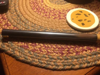

Many years ago I shortened the barrel on my old Ithaca M37 (wish I'd found a spare barrel and cut it instead of the factory barrel, you know how that is.)
I too about 10" off the 30" barrel and saved that piece (for some reason.) It ended up in the attic for well over 20 years. I found it one day, surface rust all over it where I'd handled it during the cutting process.

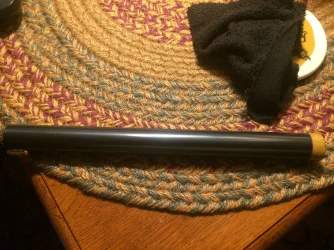

I took some 0000 steel wool and light oil (probably 3n1 oil but it could have been Mobil 1 in the little squeeze bottle) and very quickly rubbed the rust off. It won't remove pits or get the rust out of a pit, but it will remove light surface rust. Ugly surface rust. You do have to keep a coat of oil on the metal (just like you did before) to keep it from rusting.
Before
After
