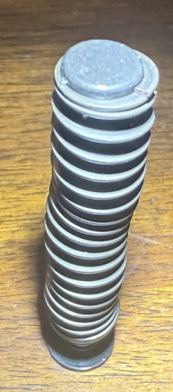

I had the recoil spring assembly issue, where the front of the recoil spring wasn't seated properly under the front of the guide rod.
Shortly after I bought my BG 2.0 (late 2024) I ordered a replacement RSA from S&W, but what I received was exactly the same as my original crappy RSA.
I broke down and ordered an aftermarket RSA from Galloway Precision and it's been 100% perfect.
But… I didn't want to let S&W off the hook that easy, so… fast forward to two weeks ago. I ordered another replacement RSA from S&W (no charge). I received it yesterday and it is 100% perfect, so S&W is now shipping their revised RSA's now.

"so S&W is now shipping their revised RSA's now."
What exactly on the RSA has been revised?
Can you post a photo?
Sure… Here's my new RSA. Notice the end of the spring isn't sticking up past the guide rod?
Wow!!...
Thank you for the photo.
I am completely as a loss to understand how that works?
The guide cap is not centered in the spring. That is why, when attempting to assemble the front of the guide rod into the front of the slide, it will not seat until the spring and cap are in the center of the guide rod port in the slide.
The end of the spring is not captured under the guide rod cap.
In my guide rod, if I move the end of the spring out from under the cap, the spring will immediately want to fry off the front of the guide rod and over the cap.
One change I see is the end of the spring is now flat against the spring and not canted at an angle.
Your welcome. Yes.. now the spring sits flat against the inside of the slide, but also the very end of the spring can't get lodged between the barrel and slide anymore. I also believe this is the reason we were seeing RSA'a bending and breaking. I'm taking it to the range tomorrow; I'll let you know how it does, but I expect it should be perfect.

Had no issues with the original RSA thought it was tough to put back in on occasion it worked fine. I went with the Galloway replacement and so far happy with it. I'd like to see the original and this new RSA side by side in a photo. Can't quite grasp the differences by the single photo only (sorry old brain).
