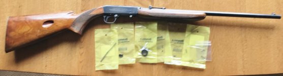

I picked up this sweet little 22 a while back (paid too much :o). But I have always wanted one of these Belgian beauties since shooting one that belonged to my Dad's friend in the 1960's.
Manufacture date on this one appears to be 1961 and it has the desirable rotating rear sight adjustment. It is only in average cosmetic condition which is fine by me, but unfortunately has some functional issues.
I was getting about 50% failure to fire and/or failure to eject with multiple types of LR ammo, including CCI Standard and HV, Aguila, and Remington. Between Brownells and Numrich I have been able to obtain most of the parts I think I need, including extractor, trigger spring and various other pins and springs. However both sources have two critical parts on back order with "no idea" when they will be available.
If anyone has any leads on where to obtain these two tiny springs or any other advice on doctoring up this soon to be great little plinker, I would be most appreciative.
Barrel Lock Spring #B2166548
Barrel Adjuster Follower Spring #B2166553
Sorry for the poor cell phone pic, but that's it for the moment. If I can get this functioning properly, I may consider refinishing the stock. One thing at a time.

It looks like Midway has the barrel adjuster follower spring. I have one that is identical to yours. I think mine is about 1958. Love 'em! Did you check with Browning to see if they can provide the lock spring? I've ordered parts from them for my rifle.

I already knew the forum is the source of all knowledge, and once again it has been proven. I was able to order both the springs I need from Midwest Gun Works. They say in stock. I had previously looked at the Browning site, but they want you to print the order form and fax it in. Since I have neither a printer or a fax, I kept looking. At $5 per teeny spring I was tempted to manufacture one from a ballpoint pen, but decided against it. I hope to update this thread in a couple weeks when I am shooting the center out of a target. I promise not to club any unsuspecting mammals with my prize. Thanks so much for the support.

Update: I obtained the required parts that I suspected were failing from several different sources listed above. It was sort of hit and miss as to who had what in stock. Now, the pretty little Browning is shooting pretty little half inch groups. One failure out of 100 rounds of various 22 ammo at speeds from sub-sonic to high velocity. Only remaining problem is that it is shooting about 3" high with the rear sight in the lowest position. Now on the hunt for a taller front dove tail sight. I love this gun!
