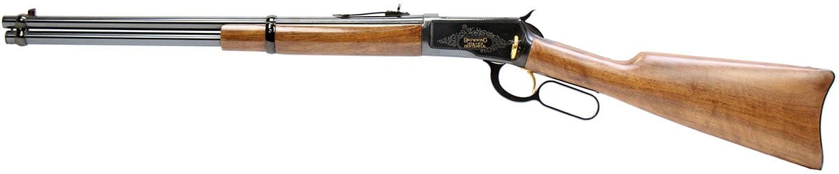

I put this B92 in .44 magnum on hold while I ponder whether to commit .
My gut says it's worth paying almost double what I see used Rossi R92's selling for,
What say you?

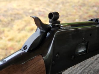

We then removed the safety on his Rossi, because now the safety is under the Lyman 66LA Peep sight.

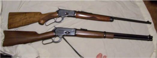

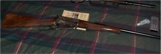

I have three Browning Winchesters.
A 53, in 32/20. An 1886, in 45/70. And an 1895 in 30 Army.
They are all three excellent rifles.

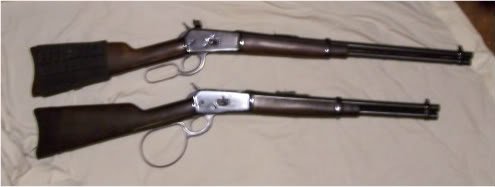

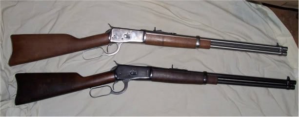

I also have Rossi 92s in 44/40, 44 Magnum and 45 Colt. Used to have a 357 but I gave it to my daughter.
In my opinion the Rossi 92s are just as good of guns as the Brownings.

What I like about the newer Rossis is that you can replace the wonky little safety lever on the bolt, with a peep sight from StevesGunz. I've always hated buckhorn rear sights and a peep is a lot easier for me to use, plus the sight radius is increased.

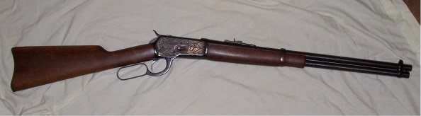

I have a EMF model 1892 saddle ring carbine in .357. These were made by Rossi for EMF to a nicer fit and finish. Mine is color case hardened and is a dandy shooter. I replaced the ugly and unnecessary bolt safety with a plug kit from Steve's Gunz and it's never given me a problem shooting both .38 Specials and .357 magnum ammo. I've taken several whitetail deer and feral hogs with it. A few coyotes too.

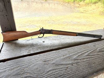

I have a Rossi '92 in .45 Colt. I got it from Steve Young. I had him do an action job and also had him bead blast it. This has been a great little saddle gun and truck gun...and accurate. I might add that it's also much smoother than the Marlin and Winchester lever actions that I own. I don't have a Browning '92 with which to compare it, but after thinking it over, I don't know how I could improve upon it.
Love that bead blast.

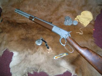

5) Rossi started putting a pig tail safety on the bolt about 15 years ago and its in my opinion an unsafe design as its way to easily brushed to the on or off position without the shooter being away of it. But it is easily removed and replaced with a plug you can get from Steve's Gunz. It will still have the quarter cock notch that the original 1892 had, and its easily carried with the lever slightly opened, which takes it out of battery and prevents the hammer from contacting the firing pin.
6) In addition to the 20" carbine in .45 Colt shown at the top, I have a 20" rifle in .357 Mag and a 24" rifle in .357 Mag. Both are 2 MOA 5 shot group rifles at 100 yards with a tang sight. Velocities with Federal 158 gr Soft point (American Hunter or Champion) average 1820 fps, and are effective on deer to 150 yards where the bullet still has 1350 fps and 640 ft pounds of energy. I zero at 150 yards which gives me a very reasonable maximum mid range trajectory of 3.7". I do the initial zero at 50 yards with a 3" high point of impact and then verify at 150 yards.
