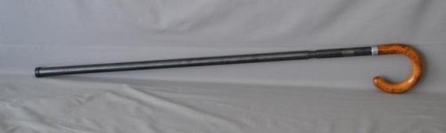

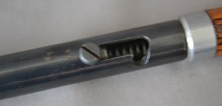

Here's my Griffon Morris Lawing cane gun.
It appears to be 36 caliber and to load it you unscrew the long metal tube part of the cane from the 1.5" barrel and chamber and put powder, patch, and bullet into it like a typical muzzle loader.
You then pull the spring loaded hammer back and lock the button trigger into the notch and place a percussion cap on the nipple.
To fire it you simply push the button trigger to the side and the hammer slams forward into the cap.
Not an ideal defense weapon but in a pinch it would probably work and it is kinda-sorta concealed carry. :)
From the powder residue in the barrel and tube it has been fired before but I have no idea what the powder charge would be so I've never tried it.
Since it's an antique and the ATF doesn't classify muzzle loaders as firearms I could "theoretically" carry it with me as a cane on a plane or other places where firearms aren't allowed as long as there was no charge or cap in it but why invite the hassle that this would no doubt create? :eek:

Since it's an antique and the ATF doesn't classify muzzle loaders as firearms I could theoretically carry it with me as a cane on a plane or other places where firearms aren't allowed as long as there was no charge or cap in it but why invite the hassle that this would no doubt create? :eek:
I'm betting the TSA would call it a firearm. I agree it would probably be quite the hassle.
Boarding an airplane with that would be begging for trouble.
I'm guessing it would be classified as a curio or relic. Sounds like reloads would be slow indeed. A Deringer in the pocket would be a lot more practical for someone seeking protection back in the day.
Just thinking that any place you wouldn't think it wise to carry an unloaded percussion pistol or revolver around,,the same thought would likely apply to a carrying a percussion Cane Gun.
Some States (and Local Laws) outlaw them,,Fed Antique Status or not.
A few States don't recognize the Fed Antique Status Firearm wording of the GCA either altogether.
But with any type of firearm,,,don't bring it into an Airport & try boarding a plane with it.

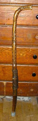

I have never had to give up my cane, other than to run through the X-Ray, and they offer me a substitute cane to go through security. Soon as it clears X-Ray they give it back to me. This has been out of St Louis, Atlanta, Zurich, Paris, Copenhagen, Seattle, Denver, and Detroit.
I limp /shuffle with a cane. I have to give up my cane to the baggage person when flying. Upside is that a stewardes helps me to my seat.
I hobble along with a cane too but have never had to give it up when flying though it does get screened when I go through airport security.
