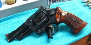

I'm going to look at a 27-3 this afternoon. I don't have to pay him today but he wants a commitment or not.
From his description on the phone, I imagine it is a mid range shooter condition. No box. 4" barrel. What he descripes as "large" grips.
Is there anything to look for that would make it special? And, is in worth around $450.00??

Might have lost my shirt but I told him I'd take it. Picking it up tomorrow.
It does have a problem and I'm not sure what it is. Hope it can be fixed for not too much. BTW, the checkering on the rear sight matches the rest of the checkering. Thanks for the info.
The big issue is that the cylinder does not swing out easily. The rod moved freely but the cylinder is hard to push out. There is a gap between the barrel and front of the cylinder so it's not binding there. Cylinder spins OK when it's out of the frame. The back of the frame has a rub mark that is deeper than my 19-2. I'm just hoping there is a fix for whatever the problem is. And, I gave him significantly less than $450.....

And the problem was: A loose ejector rod. Screwed it in and everything is good. For once I may have not paid too much ..
It's still pretty much a shooter grade but I'm happy with it. Range time later this week. It will be interesting to see how the 27-3 shoots compared to the 19-2.
One gentleman commented on the rear sight and checkering so I included a picture of that. If anyone sees anything that does not look right, please let me know. I'm always trying to learn.

Good buy--28s in that condition are bringing more than I would guess you paid for your gun.
Thanks for all the positive comments. At just a hair over $300 I also think it's a bargin. I have never shot a model 27 and it will be fun to see how the felt recoil is with .357 rounds. They are a little sharp in the 19 but I think the 27 will take care of that...
