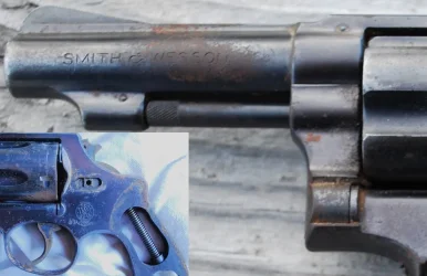

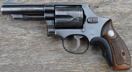

My wife’s friend Cindy has her father’s .38 special snub. He was the Chief of Police of a town in Ohio.
She gave me the .38 today to clean and tell her what it is. Well it’s a little over my head and I’m not sure as it’s a pre model number.
I’m posting pictures and not concerned about showing the serial number. She never plans on selling and is going to leave it to someone in her family. Could you all tell me about it and just a ballpark on value for insurance.

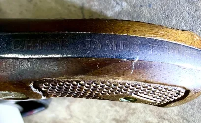

One other question it has some service rust the backstrap especially I guess from sweat from the hand. His name is engraved there Chief James E. Boggs.
I have had good luck in the past on several firearms with surface rust by using 0000 steel wool and oil sparingly. Would this be okay? Appreciate any info on approx. date of manufacture. She said he carried it daily in the 50’s.🇺🇸

I have to agree with [email protected] some bronze wool with a good solvent, followed by some RenWax. Be particularly gentle on the name engraving, because this revolver has some great provenance. Looking at the picture of the left side of the barrel, it looks to me like the barrel was re-blued...the stamping is very dished out. But maybe it's just my old eyes! In any case, you will never be able to completely remove all of the rust pits and wear, but that just adds to making this an interesting family heirloom.
This one looks to be S&W J-frame Chiefs Special four-screw version (sometimes referred to as a 'model of 1953'). My guess on the date it shipped would be late '56 to mid-'57. Just a guess....Bob will be along to narrow it down for you.
Prices for these are all over the map, and condition is a prime factor in determining a value. This one is not in bad shape, nor is it in very good shape. The value to the family would be more than the market would bear. My guess is it might sell for about $450 to $500 on a large auction site. All guesses on my part.

No.
The best description is what the company called it: .38 Chiefs Special.
Smith & Wesson never (that's an absolute: NEVER) called it a "pre model" or a "Model of 1953".
If you absolutely "must" add an additional descriptor to the name, say it has a four-screw frame.

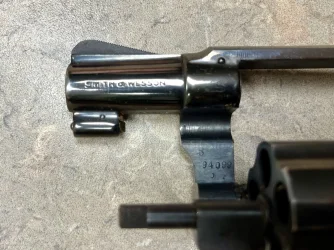

Here are a few examples of Chiefs Specials serial numbers shipped near your friend's:
- 76262 & 76717, shipped on May 3, 1956
- 80760, shipped on May 25, 1956
Your friend would need a historic letter to tell her the exact ship date and destination ($100), probably a good investment for this one! Smith & Wesson neither produced nor shipped revolvers in serial order so it's all a guess without a letter.

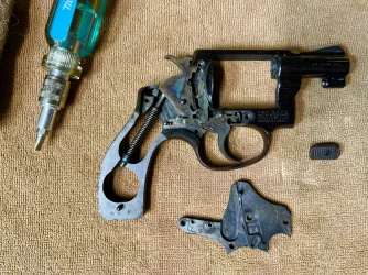

I gently tore down Chief Bogg’s Chief Special tonight and gave it a good cleaning.
It’s a pleasure to work on something that doesn’t have a single piece of plastic everything steel.
I used Kroil and bronze wool and it cleaned up great for having surface rust and being almost 70 years old.
I feel like I did something good today helping preserve this piece.
Thanks for the advise and recommendations.😉🇺🇸IMG_9822.webpIMG_9825.webpIMG_9824.webp

You did a very nice clean-up job on that! What did you use to restore the wood stocks?

When sold would this have had the red box or blue box? Also what is the number located on the crane? The number is also located on the side plate.
