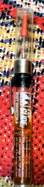

Found a couple more needle oilers. Amazing the stuff that is on my work/cleaning bench. I find stuff that I didn't know that I had!

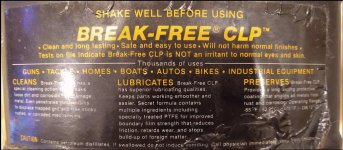

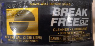

I bought a gallon of BreakFree CLP probably 41 years ago. I still have about 1/5 left. I always liked the smell. It does a good job of cleaning and lubricating. For very long term storage it will gum up.
I do have to shake it well and then put it in a smaller plastic jar and run it in my vibratory tumbler for a fair while to unclump it. I don't use it for lubrication so much anymore.
I can't find a date on the jug. My first BreakFree was in about a 1oz bottle from Radio Shack labeled as Archer BreakFree. I don't think I'd buy a gallon of it again.
