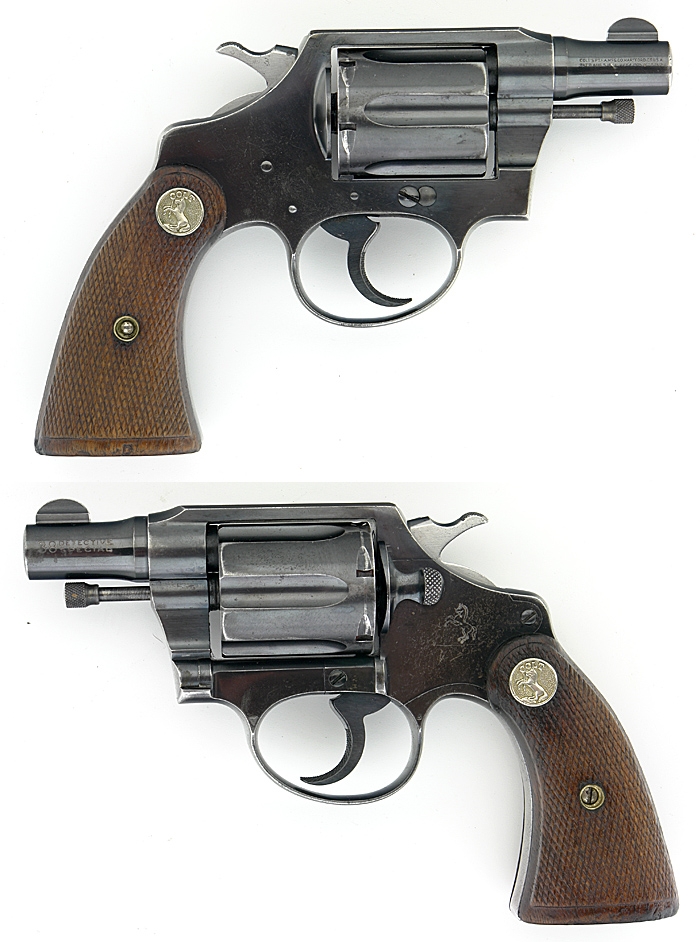

Here's a 1928 Det. Spl. I found on the net that looks like yours with the same barrel markings. It looks pretty much like yours in the pic, but with your cylinder partially open, it gives the illusion your barrel is shorter.
VERY EARLY 1928 COLT DETECTIVE SPECIAL MINT CRISP!
I think the small "Detective" over the small "Special" stamping cannot be seen well in the above picture, but it is there. Enlarge one of the other pictures of the barrel in the listing which shows it more clearly. The OPs picture does not appear to have "Detective Special" in 2 lines stamped on the barrel, just "38 SPECIAL" of the same size. The Serven book's picture of a first issue DS also clearly shows "Detective Special" in two lines stamped on the barrel, with the taller "38" to the left of them.
It also appears from the OP's picture that the barrel length is a little shorter than that of the real first issue. I have no doubts that at least the OP's barrel in not factory original.
The early PPS barrel marking had the words Police and Positive on top of each other followed by 38 Special in one line, matching the OP's barrel's appearance.
I'm with DWalt. The comparison of the two photos, as posted by dump1567, shows that the DS billed as original 1928 has a different barrel marking.
Therefore the OP's gun has a cut Police Positive Special barrel, which matches everything else about the gun, except the "eagle" on the medallion. I'd like a close-up not washed out by flash, but a silver-colored eagle would indicate a Sile aftermarket grip.
