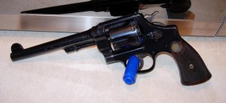

I don't think your gun has been converted to fire 45 AR or acp with
clips. If it had there would be a gap between the rear cyl face and
recoil shield similar to a 1917 model to allow for the extra thickness
of the AR rim or moon clips. My S&W second model was used in
Canada I believe and converted to 45 AR & acp and is stamped 45 AR
on the barrel. The extra space behind the cyl is easily seen and it has
lots of British proof marks. As to Canadian specific markings I don't
know for sure what to look for.

your second model is a beauty, im currently looking at one in 455 .nice piece of history
Thank you. It is in very good condition considering it's age
and looks to have been fired very little. If you are considering
buying one to go along with your Colt and reloading for them
realize that revolvers originally chambered for the 455
cartridge will have chamber throats that are oversize for the
.452 cast bullets that are commonly used in handloads. Bores
and chamber throats for the 455 typically are larger than
what is seen even in old 45 Colt revolvers. The bore of my
S&W is a reasonable .454 but the throats slug out at about
.458. I have read accounts of S&Ws made for 45 acp or 45
Colt with chamber throats this large and obtaining accuracy
is challenging to say the least. Shooting my gun with .452
bullets is a waste of components and I have some .454 cast
SWCs I plan to try when it warms up a bit . Good luck with
your Colt. Looks like it's in very good shape overall.
