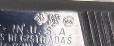

Buy it and shoot it, don’t stick it in the safe! It has enough “character” to not be considered a true collector’s pistol. The metal looks better than the grips but I don’t think it’s been refinished.

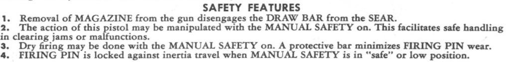

The safety is strictly a firing pin block so it’s working correctly. I would advise against using the safety as a dry fire tool, repeated hammer falls will peen the safety and hinder its operation.
