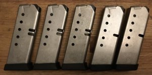

It was interesting to see the mags that came with my example were obviously modified CS45 mags. This is something I will probably do because I have lots of CS45 mags.
The attached picture from left to right is, three 6 rnd 945-1 mags, a CS45 mag and a pre-rail 4513TSW one. You can see the CS45 indentations on the 945 ones, (and the CS45,) and the 4513 doesn't have them. I can only "assume" that the 945 needs these type of magazine. (?)
Jim

My apologies Jim I had it backwards.
The 945-1 fits the CS 45 but not the reverse. I just checked mine because I knew I had done it before.
I am quite sure the only difference is the 2 cutouts vs 1 in the 945 vs CS45
If you could machine duplicate the 2nd cut out they would be completely interchangeable.
The mags themselves w/o baseplate are identical except for that extra cutout.
My guess is they made the 945 much later snd designed it so it would also work in a CS45. I'm curious if it would also work in a 6 round 4513TSW.
My guess is they made the 945 much later and designed it so it would also work in a CS45. I'm curious if it would also work in a 6 round 4513TSW.
Yes the 6rnd 945-1 magazines fit and function in both the CS45 and 6rnd 4513TSW.
I'm still wondering if the CS45 "indentations" at the top of the magazine are necessary in the 3.25" 945, (like they are with the CS45,) or wether the PC was just using the existing CS ones? I'm also curious if all 6rnd 945 magazines have these indentations.
Apparently only the 3.25" 945-1's and CS45's have them. None of the other numerous compact magazines are like that.
Jim
Looks like the 945 6rnd magazine is nothing more than a modified 6rnd CS45 magazine. The 945 magazine has a higher slot for the magazine catch release.
On another note, 7rnd 945 magazines work in the 6rnd 945 and stick out past the base of the frame an extra 1/2 inch or so.
