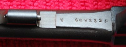

Have your uncle roll the cylinder out and look at the bottom of the barrel. The "V" should also be there, and there might be a "P" proof mark, too. (photo 4)
The fourth image shows the left side of one of my Victory models, and like Guy's, it's chambered for .38 Special and has a 4" barrel. It shipped to the U.S. Navy in late '43, and I don't think it saw any action in the war. Then it went to the municipal police, "polizei," in Bavaria in southern Germany after the war, and I don't think anyone there used it either.
