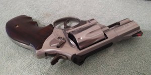

I thought it would be interesting/fun to see/discuss some customized S&W revolvers... here's a summary of the modifications that I've made to my 686+ along with a pic:
Personal Modifications:
- Apex Evolution IV DAO Hammer
- Apex Firing Pin and Spring
- Power Custom Trigger
- NOS Stainless Steel Rebound Slide
- 14# Rebound Spring
- Wilson Combat Mainspring
- Power Custom Cylinder Stop
- Lightly polished contact surfaces
- NOS Stainless Cylinder Release Bolt
- SDM Cylinder Release Thumb Latch
- D&L Sports Fixed Rear Sight
- Original Precision Lock Plug
- Polished Cylinder Ring (just finished this earlier today)
- Texas Grips American Holly Grips
- BK Grip Adapter
Gunsmith Work:
- Bead Blasted
- HIVIZ Green Fiber Optic Front Sight
Post a description and some pics of your personalized Smith.

A question about the APEX hammer: The APEX site is advertising very light double action poundage using their hammer and trigger return spring. Have you measured your single an double action trigger weight? Do you get a reliable trigger return with the APEX spring ?
Apex states that it's possible to get the Evolution IV (dao hammer) pull down to as little as 4# and the hammer ships with two rebound spring options (competition and duty), but they don't list the weights of each.
Since the Wilson Combat spring kit also included 12, 13, and 14# rebound springs, I decided to try those and see which seemed to offer the best balance between pull and return.
The 12# spring had a very nice/light pull but the return was not as "snappy" as I like... the pull with the 13 and 14# springs felt similar enough that I just decided to go with the 14# spring since the return is strong and I wanted to ensure complete reliability.
I don't have a way to measure the pull weight but it's noticeably lighter than stock and extremely smooth/consistent.
