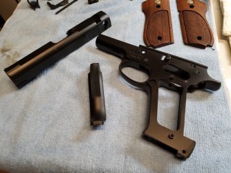

Harbor Freight has some very inexpensive HVLP small spray guns. I saved an old very abused 39-2 and used Duracoat. However, since the parts were small (frame/slide/etc) I elected to use an airbrush. I did this because I did not want to heavily coat the parts to much. It came out great. Also note that Duracoat says to leave parts alone for 30 days so it fully cures even though you can handle them after 24 hours.
