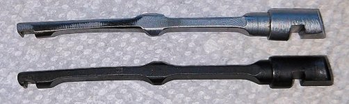

Well the State's pointless waiting period finished yesterday, so I picked it up last night after work.
Tonight I detail stripped it. This was one dirty gun, and not from the storage. It doesn't look like the previous owner cleaned it much.
You can see the crud and some corrosion on the parts. Everything got soaked in brake cleaner, scrubbed with a nylon brush, and the stubborn stuff got scrubbed with a brass brush. After blowing everything dry it all got lightly oiled and the slide rails greased. Gun is smooth and slick now.
The finish could use more work, it still has that stainless haze, but the tape residue is gone. It's going to be a working gun so not sure if I'll do too much more.
I did install the new hammer- fit was great and no more pinching.
The only snag was the left upper grip screw- the bushing came out instead of the screw. That meant I couldn't put the wood grips on. I have some NOS Pachmeyers inbound as well. I put the bushing back with blue locktite on the threads (all I have in the house) and hoping that once it sets up it'll let go of the grip screw.
It cycles dummy rounds 100% and the trigger is very nice.
Came out very nice! Make sure to hold on to the "J" hook hammer too.
Edit: Just went back and saw yours never had one or somebody swapped it out already? Oh well, still a great collectable.
