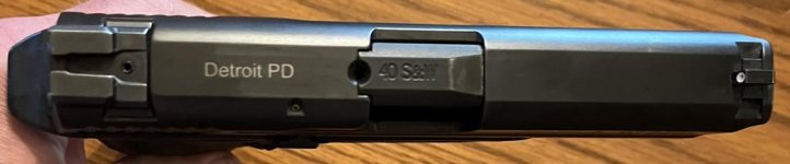

Detroit PD M&P 40 from Aimsurplus

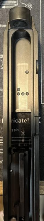

The dimples are factory marks that identify which milling machine made the slide. We all have some variation.
